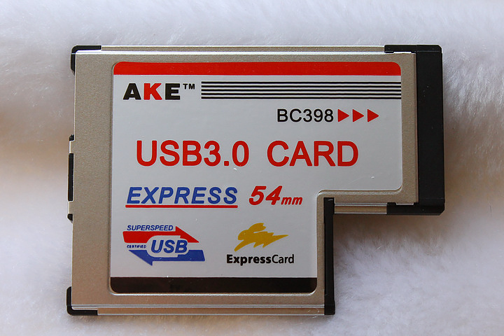

幫U5F筆記型電腦再次小升級... Express Card to USB 3.0 轉接卡
舊 2011-08-04, 04:46 PM #187
